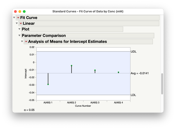

I wonder whether using the Fit Curve platform might be an option.  This platform supports the comparison of parameters; I've only ever used it for nonlinear relationships but you can use it with a linear model.  Here you can do an equivalence test in the form of Analysis of Means (ANOM) for each term in the model.
Here is a comparison of the slopes for the data supplied by @Byron_JMP
Here is the link in JMP's online help:
parameter comparison
