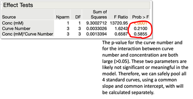

Re: ANCOVA: Interpret the JMP ANCOVA result. (4 possible combination)
attached is an example data table. Click green triangle next to the table script, "Pool Curves?)
