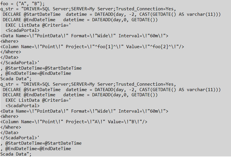

I try to run the script and insert the data into the box panel. When I try to press OK button nothing happens.
Please, see log below

 When you say it didn't work, can you explain what you are seeing. @gzmorgan0 was correct in catching my fault, where I should have used Eval Insert Into instead of Eval Insert :
Also, are you replacing the Server name in the string shown above ?
Additionally, you are only constructing the string so far, you need actually run the string after constructing it to see the results as shown in the example below from the Scripting Index :

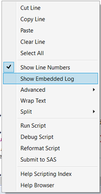

  You still haven't pasted the log. If you hit Ctrl + Shift + L on the JMP home window, a log window will open up. Alternatively on your script editor, right click and select "Show Embedded Log" as shown here before running your script:
Additionally, you are again defining strings with separators outside the quotes. Please refer to previous corrections I have offered and paste the log. If you fail to paste the log, I will not be able to offer any further guidance
