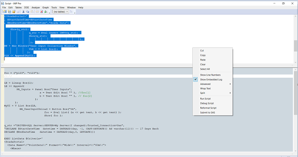

@uday_guntupalli ,
What I posted is a log - see below
The log -
foo = {"p123", "v123"};
LB = Lineup Box(1);
LB << Append(
		PB_Inputs = Panel Box("User Inputs",
				       a = Text Edit Box( "" ), //foo[1]
				       b = Text Edit Box( "" ), // foo[2]
MyUI = V List Box(LB,
		  BB_UserInputUnload = Button Box("Ok",
						  foo = Eval List( {a << get text, b << get text} );
						  Show( foo );
q_str ="DRIVER=SQL Server;SERVER=My Server(I changed);Trusted_Connection=Yes",
"DECLARE @StartDateTime  datetime = DATEADD(day, -1, CAST(GETDATE() AS varchar(11))) -- 17 Days Back
DECLARE @EndDateTime   datetime = DATEADD(day,0, GETDATE())
EXEC ListData @Criteria='
<ScadaPortal>
  <Data Name=\!"PointData\!" Format=\!"Wide\!" Interval=\!"60m\!">
    <Where>
<Column Name=\!"Point\!" Project=\!"^foo[1]^\!" Value=\!"^foo[2]^\!"/>
    </Where>
  </Data>
</ScadaPortal>'
, @StartDateTime=@StartDateTime
, @EndDateTime=@EndDateTime","Scada Data";
	Show(q_str);
				q_str = Eval Insert INTO(q_str);
				Show(q_str);
NW = New Window("User Input Collection Window",
				VLB = V List Box();
VLB << Append(MyUI);
 Are you sure that i "defining strings with separators outside the quotes" ?  Plese, can you mark the separators and tell me what do you mean.
 * The issue is that when I run the script and insert values to  Panel Box   and than i press to   Button Box("Ok"..)  ,   I dont recived any data.
Thx.

Please post your log. This script is not running a query, it is just writing the result of the query command to the log.
Which version of JMP are you using?  JMP has a Query Builder.  You could create that query to prompt for the two fields you need. Then you can save the script, or the query.  There are multiple points of failure for a query,
  • Incorrect query syntax, note that case can be important.  So if a user is typing in harry, but the db field is HARRY, then the result will be empty.  Also SQL quires quotes around a value with spaces or special characters. So first, get a script to work without the prompt, that is hardcode the values of the prompt and run the portion of code   dtScadaData =  Open Database(etc.)
  •  Once the hardcoded script works, then try the prompt typing in exactly what was hardcoded above.  Also print out  the string and compare.mple,
  • The query login can be a point of failure
  • Your connection string to the db driver may not be the same as another users.  For example, I set up the driver for Excel to be named Excel Files, someone else might have a different name.
  • Other user privileges might be different than yours, they might not have access to the files/tables.
  • I am sure there are more,
I see that @uday_guntupalli just responded. So I will stope now.
