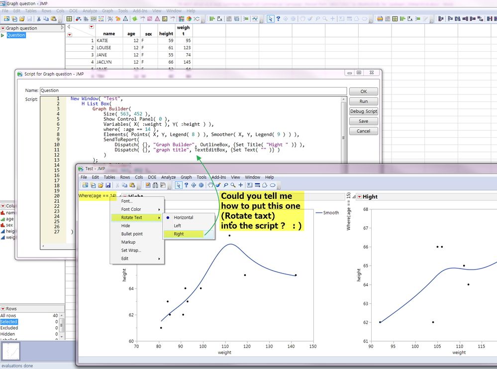

A Simple JMP Script question: How to rotate word which is outside of graph
Hi All,
I'd like to rotate a word "where( :age==14)" which is outside of graph in a popup window.
Here is the script.
Could you tell me how to make a script?  Thanks in advance. : )
nw = dt << Graph Builder(
 Size( 563, 452 ),
 Show Control Panel( 0 ),
 Variables( X( :weight ), Y( :height ) ),
 where( :age == 14 ),  //   <-  I want to rotate this text in the graph window.
 Elements( Points( X, Y, Legend( 8 ) ), Smoother( X, Y, Legend( 9 ) ) ),
 SendToReport(
  Dispatch( {}, "Graph Builder", OutlineBox, {Set Title( "Hight " )} ),
  Dispatch( {}, "graph title", TextEditBox, {Set Text( "" )} )
txnelson
Re: Simple JMP Script question: How to rotate word which is outside of graph
Here is a method that I have used in the past.  It uses an invisible Outline Box() to gain easy access to the Text Box() you want to manipulate, which lies outside of the Platform Object
nw = New Window( "the output",
	ob = Outline Box( "",
			Size( 563, 452 ),
			SendToReport(
nw[Outline Box( 1 )][Text Box( 1 )] << rotate text( left );

Steve_Kim
Level IV
Hi Phil,
Thank you for the answer. : )
However I'd like to Rotate the text box "where( :age == 14 )" ,  Not Y-axis title.

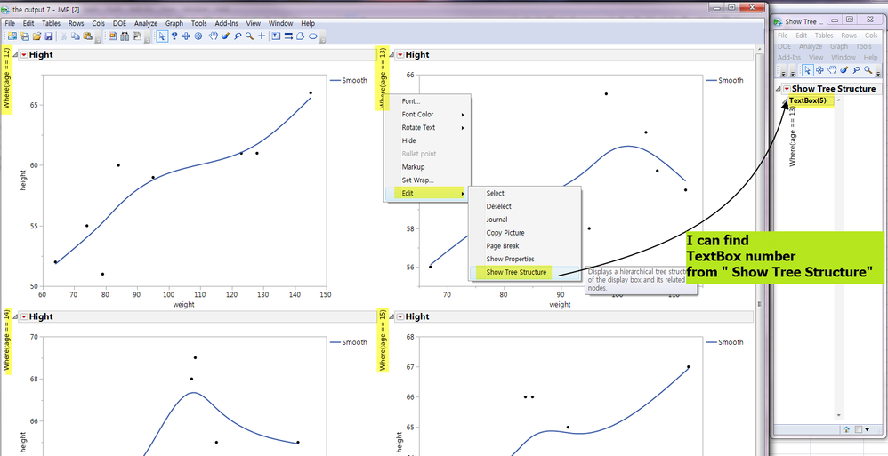

dt = Open( "$SAMPLE_DATA/Big Class.jmp" );  // data table
	H List Box(
		Graph Builder(
			Size( 563, 452 ),
			where( :age == 12 ),  //   <-  I want to rotate this text in the graph window.
			SendToReport(
		),   // end of graph (age=12)
		Graph Builder(
			Size( 563, 452 ),
			where( :age == 13 ),  //   <-  I want to rotate this text in the graph window.
			SendToReport(
		),  // end of graph (age=13)
	),  // end of H list box
	H List Box(
		Graph Builder(
			Size( 563, 452 ),
			SendToReport(
		),   // end of graph (age=14)
		Graph Builder(
			Size( 563, 452 ),
			where( :age == 15 ),  //   <-  I want to rotate this text in the graph window.
			SendToReport(
		),  // end of graph (age=15)
	// 	)  // end of outline box
);    // end of new window
/*Check text box numbers by clicking "show tree structure"  from the graph window*/
nw[Text Box( 1 )] << rotate text( left ); // rotate text
//nw[Text Box( 1 )] << hide (1);  // hide text
nw[Text Box( 5 )] << rotate text( left ); // rotate text
//nw[Text Box( 5 )] << hide (1);  // hide text
nw[Text Box( 9 )] << rotate text( left ); // rotate text
//nw[Text Box( 9 )] << hide (1);  // hide text
nw[Text Box( 13 )] << rotate text( left ); // rotate text
//nw[Outline Box( 1 )][Text Box( 13 )] << hide (1);  // hide text
I found a "text box number"
from the "show  tree structure" button  on the window as well.
