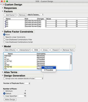

Assuming you have 4 factors at 4 levels, when using the Customer Design platform, in the Model, highlight the effects you want. If it says If Possible, you can change that to Necessary.

I tried but got same correlation again.
Did you check your correlation picture? Do i miss something diffrent?

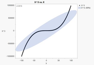

The X^3 vs X plot has a correlation of 0.916 and the density ellipse is elongated. Find 4 points on that curve that are not correlated. I don't think you can do it. Those terms will always be correlated.

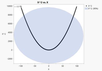

For a contrast, I have also included a plot of X^2 vs. X. The correlation is -0.019 and the density ellipse is almost circular. You can get correlations close to zero between these terms.

Coding is actually used to REDUCE collinearity. But coding can only do so much. My graphs may not be the best way to illustrate, but consider this:
 X1      X1^2    X1^3
100    10000   1000000
100    10000   1000000
200    40000   8000000
200    40000   8000000
150    22500   3375000
There is a correlation between X1 and X1^2 (0.997). But if you code to -1, +1, the correlation will drop to 0. This does not happen when cubing because, as you pointed out, -1^3 = +1 and +1^3 = 1, but the correlation on the original scale is large, too.
