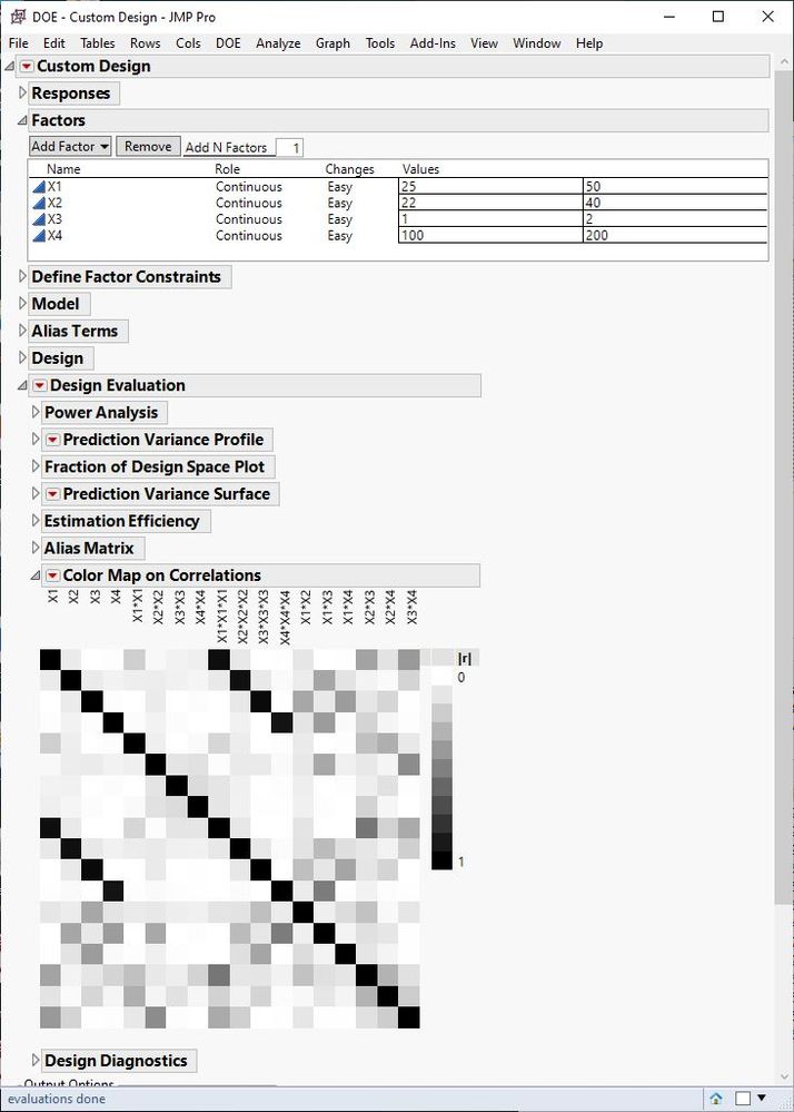

I have 4 factors and try to make a model with main effects, interactions, 2nd order and 3rd order power.
I make design with recomended optimality criteria. When i checked color map correlations i can always see x1 and x1*x1*x1 correlation near to 1. How can make a DOE that does not have this problem?     Capture.JPG

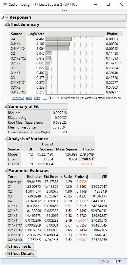

I added four continuous factors representing concentration, temperature, time, and pressure. I added terms for the second and third power of each factor to the linear model. I used the default number of runs. This example is clearly not one of the correct results:

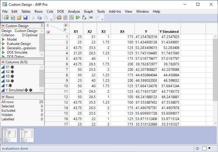

I simulated the response so that I could launch Fit Least Squares platform. The response is not involved in the correlation of the estimates, which is also indicated by VIF > 1 in the parameter estimates report. Here is the design:
Here is the report using the default coded levels. VIF around 10 indicates a correlation around 0.9.

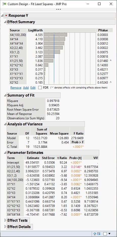

Here is the same analysis but without coded levels. The coding clearly helps:

Just to clarify, the coding used in the Custom Designer will show the correlations, which you can't get around due to the natural correlation built in by taking -1 and +1 to the third power. From the design perspective, you're still finding the D-optimal design, but the diagnostics make it look "bad".
In the future, I can see us using an orthogonal polynomial coding approach to make to make the higher order terms not look as bad as this. Note that you'll see the same issue between x^2 and x^4 if you were to include up to the fourth power.
To summarize, it's not that there's anything wrong with the design, or the correlations, but it's something that we're certainly aware of causing confusion and hope to better address this in a future version.
