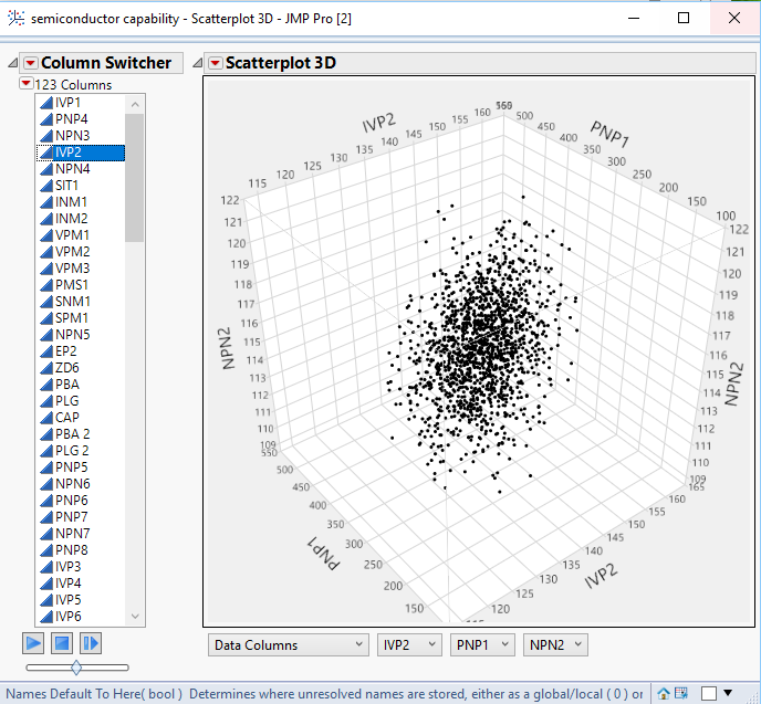

All you have to do is to use the Column Switcher.  To open it, just go to the red triangle and select:
    Redo==>Column Switcher
Below is a script that illustrates how to set this up in a script
