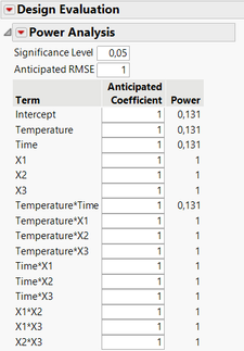

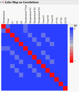

For your specific use case, if you can afford 5 plates, each with 24-deep well, the evaluation of the design seems quite positive:
I attached the Split-plot design used if you want to evaluate it.
