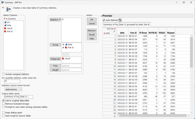

我怎么才能把pass比例小于等于97%的group自动标注出来吗?
我想得到如下效果(效果图是我手动定制的):

Perform the calculation on your data table and create labelling column. Then use that column as Color / Overlay. Also, at that point you might want to move to Bar chart instead of distribution. Optionally, you can create a summary table and create report from that with the calculations
