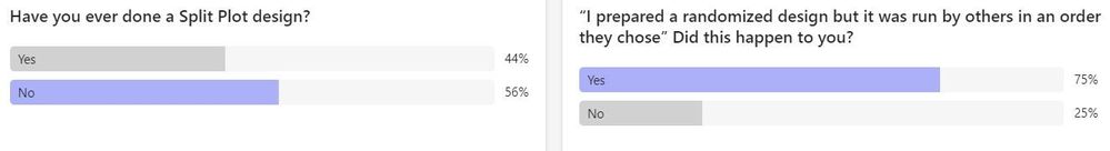

Resoults from the Poll Questions:
The discussion continued though the chat:
