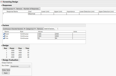

I was using Easy DoE to prepare for a simple experiment and wanted to use the current process as one of the trials, a baseline.....
My inputs are as follows:
The design, based on my requirements to have a minimum number of trials is seen below.
Unfortunately, this design does not include my current process (1000 1400 30).
Is there a way to use the other fraction of this design, which would have included my baseline process?
- Philip

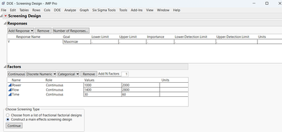

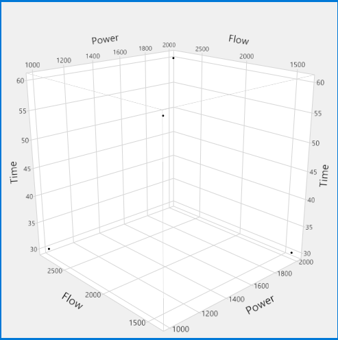

Using the platform "Screening Design" (available in DoE, Classical, Two-level Screening, Screening Design) and specifying the factors and ranges as you did, I'm able to have a design respecting the inclusion of your "forced run" by selecting the option "Construct a main effect screening design" with minimum number of runs (4) :
Proposed design (1st run does correspond to your current process conditions, DoE attached):

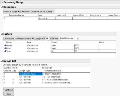

If you want to be sure the platform will always generate this design (as the other "half" can also be proposed), you can click on the other option "Choose from a list of fractional factorial design" and select the first one with run size of 4 :

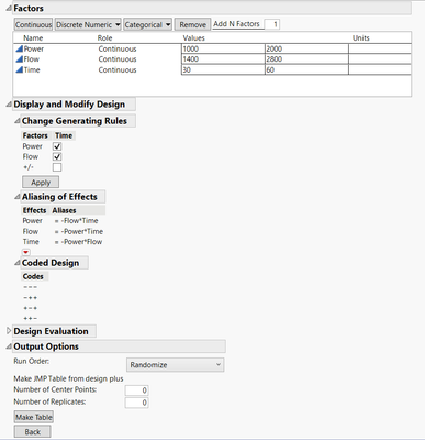

After clicking on "Continue", go into the panel "Display and Modify Design" and in the "Change Generating Rules", uncheck "+/-" and apply.
This will force the design creation to have a row with only minimum values (a row with "---"), corresponding to your current process settings (you can check the coded levels design in the related panel) :
