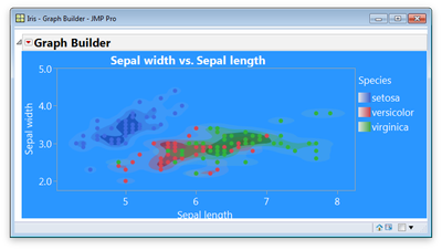

Here, the selection tool (S) is your best friend :9268_Screen Shot 2015-07-23 at 9.26.49 AM.png. For example, here is a graph I've made in Graph Builder:

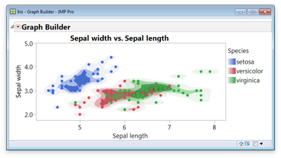

Per Sean's request, we'd like to get this publication-ready with just the legend and graph (no title). I'll use the selection tool to grab the graph:

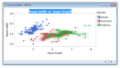

Then I will journal it by Edit > Journal (or Ctrl-J). To remove the title, I can again just select it in the journal and press the delete key.

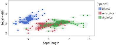

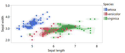

Now the title goes away, and I can copy/paste into other software, or File > Save As. Here is my final graph, ready for publication:
Another way to get the task accomplished is to actually to select the title in Graph Builder and delete it. Then I can select the graph and Edit > Save Selection As.
