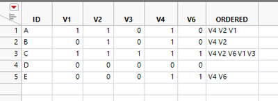

Most likely there are better ways to do this, but here is scripting heavy solution which seemed to work with example data:
Names Default To Here(1);
//Example datatable
dt = New Table("Q OF THE DAY",
	Add Rows(5),
	New Column("ID", Character(1), "Nominal", Set Values({"A", "B", "C", "D", "E"}), Set Display Width(38)),
	New Column("V1", Numeric, "Continuous", Format("Best", 12), Set Values([1, 0, 1, 0, 0]), Set Display Width(38)),
	New Column("V2", Numeric, "Continuous", Format("Best", 12), Set Values([1, 1, 1, 0, 0]), Set Display Width(38)),
	New Column("V3", Numeric, "Continuous", Format("Best", 12), Set Values([0, 0, 1, 0, 0]), Set Display Width(38)),
	New Column("V4", Numeric, "Continuous", Format("Best", 12), Set Values([1, 1, 1, 0, 1]), Set Display Width(42)),
	New Column("V6", Numeric, "Continuous", Format("Best", 12), Set Values([0, 0, 1, 0, 1]))
colCount = 10;
dt = new table("example",
	add rows(1000),
	New Column("ID", Numeric, Ordinal, << Set Each Value(Row()));
For(i = 1, i <= colCount, i++,
	dt << New Column("V" || char(i), Numeric, Ordinal,
		<< Set Each Value(Random Binomial(1, 0.9))
colNames = dt << Get Column Names("String");
//Drop ID column
colNames = Substr(colNames, 2);
//sorting list https://community.jmp.com/t5/JSL-Cookbook/Sorting-Lists/ta-p/240795
//create ranking based on sums and column idx
sumsOfCols = V Sum(dt[0, colNames]); //order is same as in coLNames
orderCols = Reverse(Rank(sumsOfCols));
newCol = dt << New Column("ORDERED", Character, Nominal);
For Each Row(dt,
	//Indices of columns which have 1
	idxWithOne = Loc(dt[Row(), colNames]);
	//if all values are missing continue to next row
	If(N Items(idxWithOne) == 0,
		continue();
	//fill list with empty values
	tempList = Repeat({""}, N Items(colNames));
	//replace empty with colnames which had 1
	tempList[idxWithOne] = colNames[idxWithOne];
	//reorder list based on sum ranking
	reOrderedList = tempList[orderCols];
	//create string of list and remove whitespaces
	orderedString = Trim Whitespace(Collapse Whitespace(Concat Items(tempList[orderCols], " ")));
	//add value to column
	newCol[Row()] = orderedString;
Also it has no specific handling for ties.

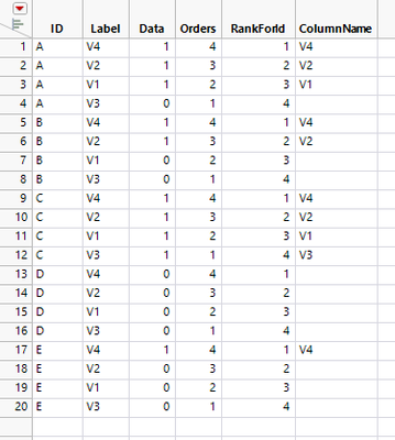

You might be also to  do this interactively:

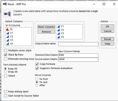

Stack data:
Add formulas:
	New Column("Orders",
		Numeric,
		"Continuous",
		Format("Best", 12),
		Formula(Col Sum(:Data, :Label))
	New Column("RankForId",
		Numeric,
		"Continuous",
		Format("Best", 12),
		Formula(Col Rank(Col Max(:Orders) - :Orders, :ID)),
		Set Display Width(70)
	New Column("ColumnName",
		Character,
		"Nominal",
		Formula(If(:Data == 1, :Label))
Sort data by ID and RankForId (select both and sort ascending):

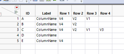

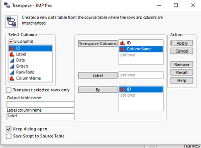

Transpose data:

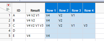

Remove Label column and Combine Row columns from Columns menu:
Remove unnecessary columns and join back to original datatable if needed.
Interactive solution might have different ordering between ties that the scripting version
