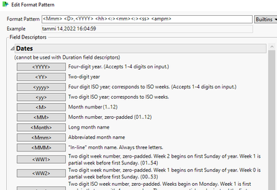

If you are using JMP16 you might have luck with Format Pattern depending on your Locale Settings:
-Jarmo
