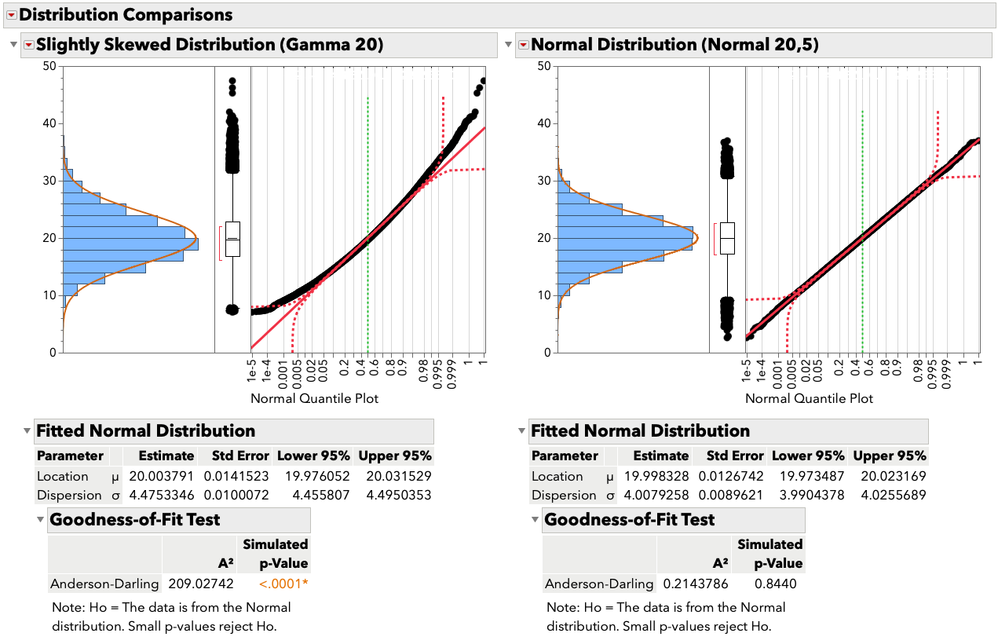

To start with I generated sets of 10 samples from normally distributed population and from a gamma distributed population using some random functions as formulas in a data table.  Random normal (20,4) and Random Gamma(20).  The population statistics clearly show that the normal distribution is normal and the gamma distribution fails a normality test (figure 1).
 Figure 1. Distribution comparisons of populations from a normal or gamma distribution. Sample size is 10,000. With a large sample size the tails of the gamma distributed population (left panel) clearly fall outside the 95% confidence intervals (red dashed lines) of the normal probability regression line in the normal quantile plot.

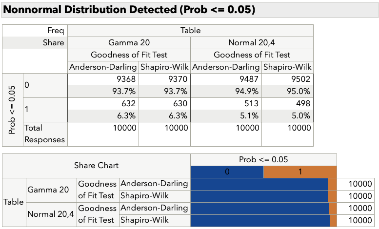

The a large data sets (n=100,000) was divided into groups of 10 and each subgroup (n=10,000) was tested for normality using the same tests used for the data set in figure 1. Small probability values reject the null hypothesis that the data is from a normal distribution so a cut-off of 0.05 was used to determine whether the subgroup passed the goodness of fit test. The tabulated results are presented in figure 2. Both the Anderson-Darling and Shapiro-Wilk goodness of fit tests flagged a similar proportion of the sample groups. Groups from the normal population failed about 5% of the time and groups from the gamma distributed population passed about 94% (failed about 6%) of the time.
Figure 2. Proportion of Samples failing Goodnes of Fit Tests. Sample groups (n=10) with a probability of being from a normal distribution <= 0.05 are labeled "1" and passing groups are labeled "0".
I was a little surprised at the type 1 error rate for the samples from the normal distribution (maybe I shouldn't have been..) This means with a small sample size about 1 in 20 times, data from an underlying normally distributed population will fail a goodness of fit test. Samples from a slightly skewed population had a similar detection rate.
