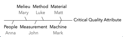

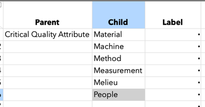

Step 1:
While you’re in the room start out with this template:
Step 2:
Ask, “Who is going to be the lead for each of these branches?” quickly type their name into the rows in the Label.

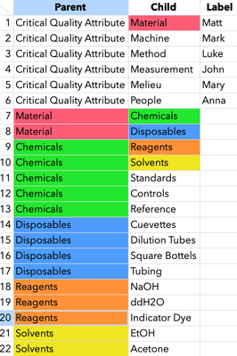

Step 3:
Now that specific people are defined, we can start going around the table talking about what goes into each branch – Whiteboard this and then enter the ideas into your table
For Example:
What are the main types of Material
  1. Chemicals. (Green)
  2. Disposables (Blue)
What are the main types of Chemicals
  1. Reagents (Orange)
  2. Solvents (Yellow
What are the main types of Reagents
  1. Sodium hydroxide
  2. Distilled water
  3. Indicator dye
In the figure below, the “Parent” has a “Child”, and the “Child” becomes the “Parent for the next level. The parent and child names are colored to make this relationship more obvious.

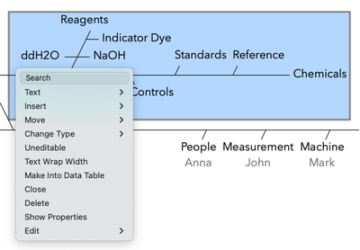

As rows are added the fishbone diagram grows; however, the formatting might not be as you like,
Fortunately, there is a nice set of formatting options. Just hover over a branch of the diagram with the cursor, and then right click to bring up the options menu.  In this case I’ve selected the Chemicals branch.
Just a couple of highlights:  the text format can be edited (color, size, bold) and the Move options let you format the position of the branches.  Lots of other options too.

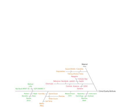

In the next meeting, ask, “Are you on track to compiling your information?”, then color the text in the diagram  according to your project risk assessment color scheme. In the example below, Matt’s Material branch for Chemicals is red, no data collection has started, but the orange branches are where the collection has started but isn’t complete and the green in completed.  Assign colors and then past this figure into your update slide for the executive committee progress report.
Also, save the script from this colored report, and save the script to your fishbone diagram data table with today’s date. Do this after each update meeting so you’ll have a record of the progress.
