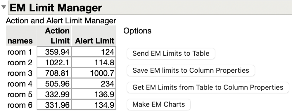

After selecting columns, A table dialog box is presented with a row for each selected column and a column for editing the value of the action and alert limit. Options include sending the dialog table to a data table (useful as a template), sending the values in the dialog table to the EM Limits column property (the new one that this script makes) Getting limits from a data table and sending them directly to the column property, as well as the dialog table, and finally a button to make a set of EM run charts that include the action and alert limits as horizontal reference lines. Note, the graph button won't work if there aren't action and alert limits.
Screen Shot 2021-08-19 at 11.17.07 AM.pngScreen Shot 2021-08-19 at 11.17.07 AM.png
