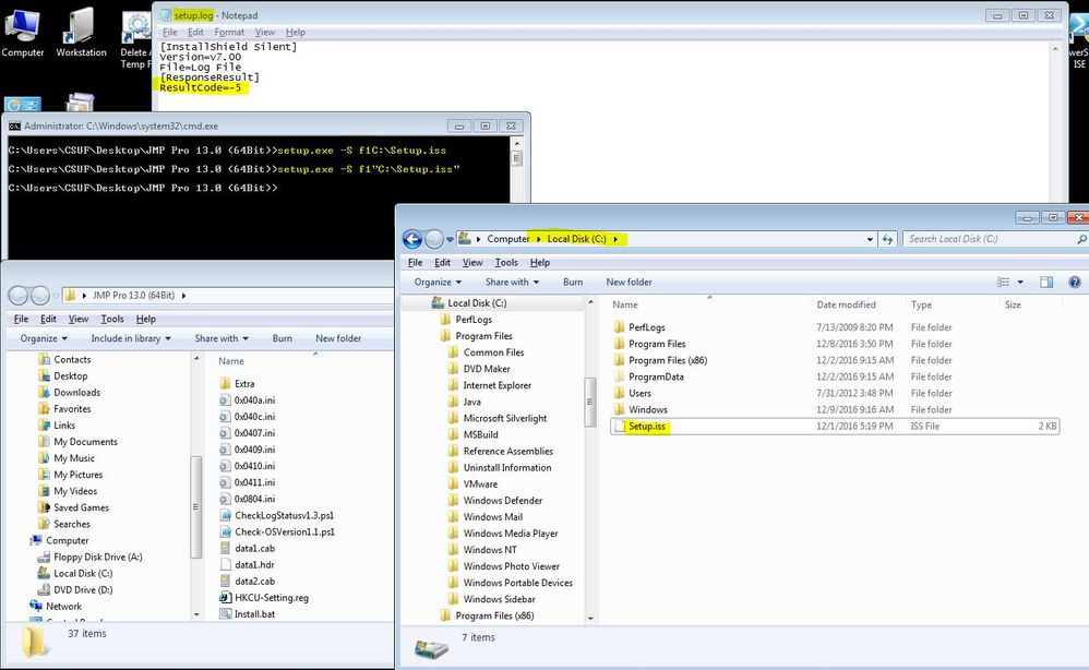

Thanks for the reply.  I have my .iss file in the root of C:\ and I am running this command from the installation directory (setup.exe -S f1C:\Setup.iss) also tried (setup.exe -S f1"C:\Setup.iss") and nothing happens and my log file is still showing a result code of -5, see screenshot below
______________
[InstallShield Silent]
Version=v7.00
File=Log File
[ResponseResult]
ResultCode=-5
______________
