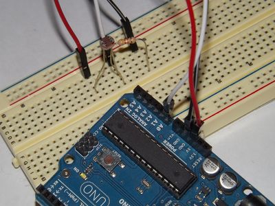

The sensor for this project is a CdS photo-resistor.  Here's a picture of the breadboard circuit.
the photo-resistor (round with squiggly line, center rear) and the 43K ohm resistor (yellow-orange-orange-gold) next to it form a voltage divider across the black wire (ground) and red wire (5 volt) power supply.  The white wire on the center tap of the divider goes to A0 on the blue Arduino UNO board.  A0 is the analog input the program above is reading.  When the photo-resistor is dark, its resistance is very high (compared to the 43K ohm resistor, and the white wire's voltage will be near ground (0 volts).  When brightly lit, the photo-resistor's resistance is very low and the white wire will be close to 5 volts.

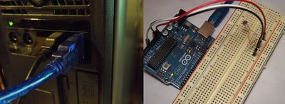

You used the USB cable as a serial port to load the program into the Arduino.  It might be com3 or com4 or maybe another choice.  JMP will be listening on that same USB serial connection.  That's a cool blue USB cable that might come with the Arduino, depending on the vendor.
