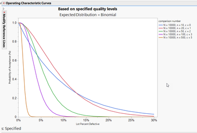

Viewing output from the second outline node displays the Operating Characteristic Curves ( OC ).  The OC curves are used to evaluate the insurance offered to both the consumer and producer by the plan. Two OC curves are displayed. The curve on the left is shown using the specified quality levels ( AQL = 0.018 and RQL =0.18) and the associated (calculated) probabilities of acceptance. Where as, the OC curve on the right is shown using the specified probabilities of acceptance ( Pa@AQL = 0.95 and Pa@RQL = 0.1 ) and the calculated quality levels.
Operating Characteristic CurvesOperating Characteristic Curves

When I use "compare Attributes Plans" feature for comparing the different sampling plans, and even though I select type B sampling plan (Binormal), it chooses a lot size of N=10000 (in this case) for comparison.

Thank you for the feedback; I think that would be a bug.
I'll correct the user interface and post an update this week.
