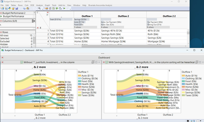

@qunw the ":" assures the sorting, the coloring should not change as Outflow 1 is set for color.
If you want to get different colors, you may want to use Value Color Property. @scwise might add to the ordering and coloring his thoughts.
To be more precise on sorting, default is alphabetic sorting with A at the bottom nad Z at the top. If you use the ":" option it will assure the sorting is within the hierarchical order. You can force the value order in th ecolumn property, though it might be more difficult if you have many flows to visualize, as the order might not apply best due to the hierarchy.
qunw
Level III
Thank you so much for the detailed instructions!  I tried this trick with my date set, and it worked!  The only disadvantage is that it requires some pre-processing work on the dataset, as the same category would be tracked in subsequent Outflows.
