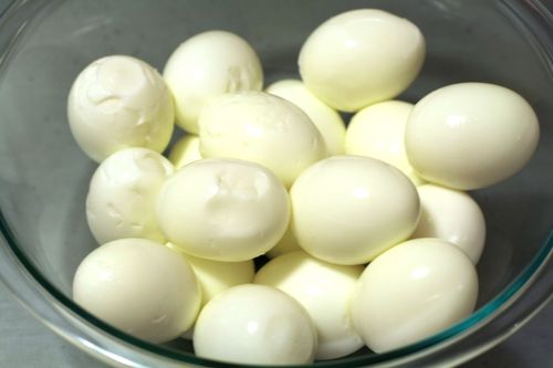

What's the best method for getting hard-boiled eggs that are easy to peel and attractive? (Photos by Caroll Co)What's the best method for getting hard-boiled eggs that are easy to peel and attractive? (Photos by Caroll Co)
A typical scene in my kitchen: I make a batch of hard-boiled eggs with the hope of an easy peel and a beautifully cooked center. But when I sit down to enjoy my egg, I find that, sadly, it’s not so easy to peel – or I have discoloration around the yolk (or worse yet, sometimes both occur).
Here's how I've been preparing my hard-boiled eggs: I start with the eggs in a pot of cold water. Then, I bring the pot to a boil, remove it from the heat and cover the pot for 12 minutes. After a recent disappointing experience with both overcooked and hard-to-peel eggs, I decided to investigate further in a quest to make better hard-boiled eggs.

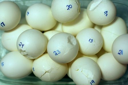

For a first try at this eggsperiment, my budget for runs was two dozen eggs – same size/brand, purchased two weeks apart. Perhaps in a future experiment, I will use more eggs, but I wanted the peeler (my wife) to be blinded from knowing how the egg was prepared. Since I wasn’t going to be doing the peeling, 24 eggs seemed to be the limit of asking for help from my wife. I also quailed at the thought of having to eat so many egg salad sandwiches in a short period of time.

  • Pre-cool crack (yes or no)
The pre-cool crack indicates whether I cracked the egg before using the cooling method in 3. If you’re familiar with design of experiments, you may recognize that not all of these factors are equally easy to change. For factors 2-4, I can assign these on an egg-by-egg basis (that is, they’re easy to change). For the cooking method, it is much more convenient if I cook more than one egg at a time. Thus, cooking method is a hard-to-change variable, or whole plot variable in the parlance of split-plot designs.
