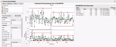

I/MR Charts – Control Chart Builder
  1. From an open JMP® data table, select Analyze > Quality and Process > Control Chart Builder.
  2. Drag a continuous variable from Select Columns (continuous variables have blue triangles), and drop it in the Y zone. By default, JMP produces a control limit summaries table and two charts: Individuals (Individual Measurements) and Moving Range (the moving range between each pair of consecutive points).  Right-click on the graph and select Limits > Sigma to change the method for estimating the standard deviation.
  3. If available, drag and drop a variable in the Phase zone (top), and click the Done button when finished.

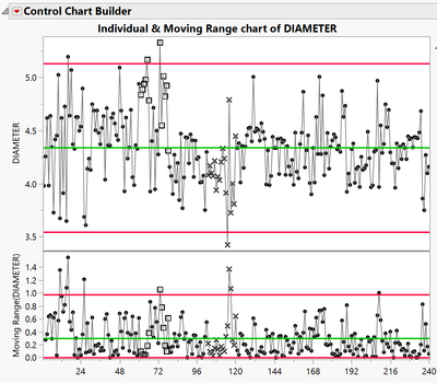

Notes:Additional options, such as tests for special causes, are available from the Red Triangles in the Control Chart platform (or Right-click on the graph in the Control Chart Builder).
Diameter.jmp (Help > Sample Data Folder > Quality Control)Diameter.jmp (Help > Sample Data Folder > Quality Control)
