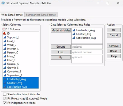

  1. From an open JMP® data table, select Analyze > Multivariate Methods > Structural Equation Models.
  2. Select the numeric variables for the model. Click OK. The SEM interactive report will open.

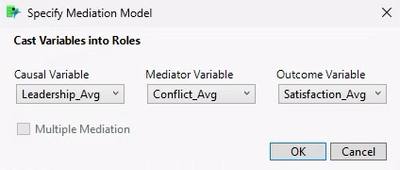

  3. From the Model Shortcuts red triangle at the bottom, select Cross-Sectional (classics) > Mediation Analysis.

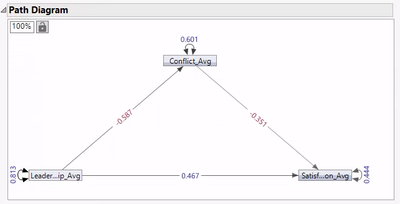

  4. Select one of the variables as the Causal Variable (here we chose ‘Leadership_Avg’), a variable as the Mediator (‘Conflict_Avg’), and a variable for the outcome (‘Satisfaction_Avg’). These roles specify a model describing the effect that ‘Leadership’ has on ‘Job Satisfaction’ through its effect on ‘Conflict’. Click OK. The path diagram will be added.

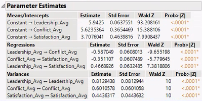

  1. Click Run to fit the model. The model coefficients will be added to the Path Diagram, and a table of parameter estimates and statistical tests will be generated.

Interpretation:
• For one unit increase in leadership, conflict decreases by 0.59 units whereas satisfaction increases by 0.47 units.
• Conflict has a negative effect on satisfaction, such that one unit increase in the former results in a 0.35 decrease in the latter.
• The indirect effect of leadership to satisfaction through conflict is positive and statistically significant (b = 0.21, SE = 0.04). Thus, leadership has a positive impact on satisfaction through its effect on conflict.
  • Other models can be fit and compared in the same report via the Model Comparison table (e.g., one without the direct effect from leadership to satisfaction to test if the effect of leadership to satisfaction is fully or partially mediated by conflict).
  • The red triangle menu of the fitted model includes options to display total and indirect effects along with their standard errors. Bootstrap for standard errors is also available in the main red triangle menu.
