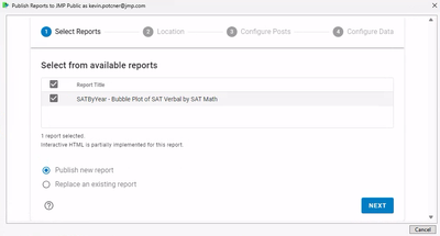

  4. A window will appear listing the reports available to publish. Select the ones you wish to publish. Here we have only one
    graph (Bubble Plot).
  5. Choose to Publish a new report or replace an existing one. Click Next.

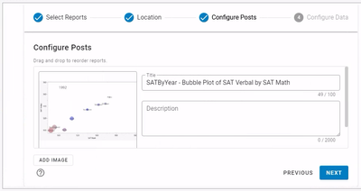

  7. Provide a Title and Description for your report. Click Next.

Select an available report to publishSelect an available report to publish
Provide report title and descriptionProvide report title and description

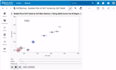

View, share and interact with published report on JMP  PublishView, share and interact with published report on JMP Publish
