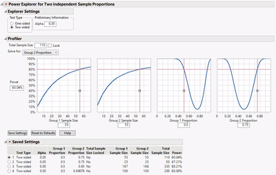

  1. Select DOE > Sample Size Explorers and choose Power >Power for Two Independent Sample Proportions.
  1. Choose the type of test: One-Sided or Two-Sided and choose Alpha (significance level for the test).
    The Null Hypothesis is that the two proportions are equal. Here we chose a two-sided alternative which is used to test that the two proportions are not equal.
    This null and alternative hypothesis can be written using notation as  H0: p1 = p2 vs. HA: p1 ≠ p2
  2. Enter values for the Group 1 and Group 2 Population Proportions under HA to base the analysis on.
    Here we consider the scenario where Proportion 1 is 0.50 and Proportion 2 is 0.75.

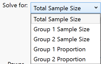

  3. Select parameter to solve for. Here we chose Total Sample Size.
  4. Enter a value for the Power. Here we entered 0.80.
    The solution of Total Sample Size of 110 (n1=55 and n2=55) is displayed.
  5. Use the interactive cross-hair tool (or type in values) for Power, Sample Sizes, and Assumed Proportions to study the relationship between these parameters solving for many different scenarios.
The settings and solution for each analysis performed can be saved. The table of saved settings shows the results of five different analyses performed when testing the hypothesis H0: p1 = p2 vs. HA: p1 ≠ p2
1. What sample size is needed to achieve a power of 80% assuming p1=0.50 and p2=0.75?
Answer: 110 (n1 = 55 and n2 = 55)
2. What is the power with a sample size of 25 in each group assuming p1=0.50 and p2=0.75? Answer: Power = 47.2%
3. What sample size is needed to achieve a power of 80% assuming p1=0.50 and p2=0.65?
Answer: 335 (n1 = 167 and n2 = 168)
4. What difference from 0.50 for the proportion of group 2 can be detected with 80% power using a sample size of 100 in each group?
Answer: 0.69
