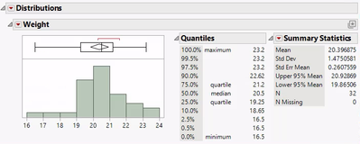

  1. From an open JMP data table, select Analyze > Distribution.
  2. Select one or more continuous variables from Select Columns, click Y, Columns (continuous variables have blue triangles), and click OK.
  3. From the Distributions report window, select Prediction Interval under the red triangle next to the variable name.

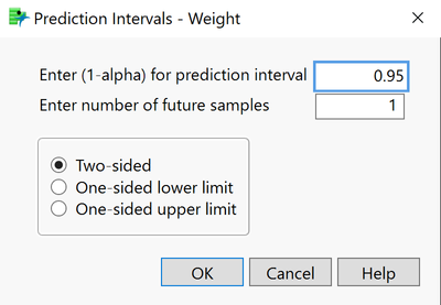

  4. Select the confidence level (1-alpha) and enter 1 for number of future samples. Choose Two-sided or One-sided interval. Here we chose 95% confidence and two-sided. JMP will add a table displaying the lower and upper bound of the Prediction Interval for an individual observation.
Note: Calculations are based upon the assumption of a normal distribution as an appropriate model for the population.

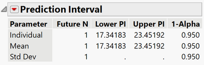

Interpretation:
It is estimated, with 95% confidence, that a randomly selected observation from this population will be between 17.34 and 23.45. Note: The prediction interval for the mean of n=1 is the same as that of an individual observation and there is no prediction interval for the standard deviation of n=1.

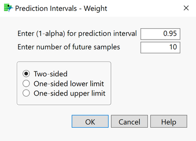

  1. Follow steps 1-4 above choosing a n>1 for number of future samples. Here we chose 95% confidence, two-sided, and n=10. JMP will add a table displaying the lower and upper bound of the Prediction Interval for a sample of n=10 observations as well as the sample mean and standard deviation.

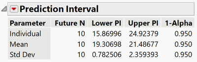

Interpretation:
It is estimated, with 95% confidence, that:
• 10 randomly selected observation from this population will all be between 15.87 and 24.92.
• The mean of the 10 observations will be between 19.31 and 21.49.
• The standard deviation of the 10 observations will be between 0.78 and 2.36.
