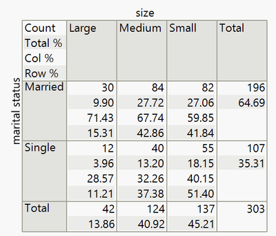

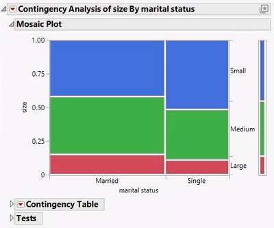

Use to examine the relationship between two categorical variables. A contingency table displays the frequency and percentages of the distribution of the data in a matrix format, while a mosaic plot graphically displays the information.  The mosaic plot is a side-by-side divided bar chart that allows you to visually compare proportions of levels of one variable across the levels of a second variable.
Creating Contingency Table from Car Poll.jmp (Help > Sample Folder)Creating Contingency Table from Car Poll.jmp (Help > Sample Folder)
Contingency TableContingency Table
Mosaic PlotMosaic Plot

  • Click on the red triangle next to Contingency Table to select or deselect display options.
  • Right-click on the mosaic plot to change colors (Set Colors) or label cells (Cell Labeling).
