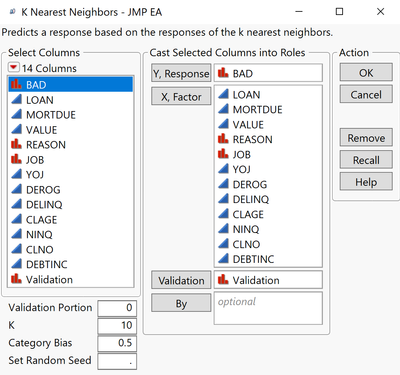

  1. From an open JMP® table, select Analyze > Predictive Modeling > K Nearest Neighbors.
  2. Select a categorical or continuous response variable from Select Columns and click Y, Response. Here, we illustrate using a categorial response variable.
  3. Select candidate predictor variables and click X, Factor.
  4. If desired, enter the Validation Portion or select a validation column and click Validation. Click OK.

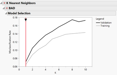

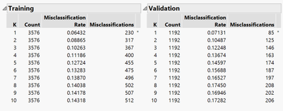

  • Graph and table showing the misclassification rates and counts across a range of values for K.

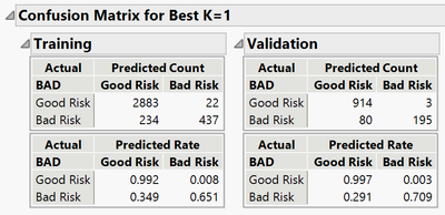

  • Confusion Matrix detailing the classification performance for the value of K with the smallest misclassification rate.
  • Mosaic plots (not shown here) which graphically shows the values in the confusion matrix.

• There are 1,192 observations in the Validation Data. The misclassifcation rate is the lowest when the prediction is based on only 1 nearest neighbor: 85/1,192 (7.1%) were misclassified. Note that the misclassification rate increases as the number of nearest neighbors increase. Of these total misclassifications in the Validation Data, 3/(3+194) = 0.3% of the Good Risk observations were misclassified as Bad Risk. 80/(80+195) = 29% of the Bad Risk observations were misclassified as Good Risk.
• There were 1,192 observation set aside for the Test Data (Results not shown). The total misclassification rate for these observations using 1 nearest neighbor is 6.9%. 0.4% of the Good Risk observations were misclassifed as Bad Risk and 3.2% of the Bad Risk observations were misclassified as Good Risk. These results are often considered to produce the most accurate estimate of what the misclassification rate will be in future data as these observations were not part of the model training nor selection process.
