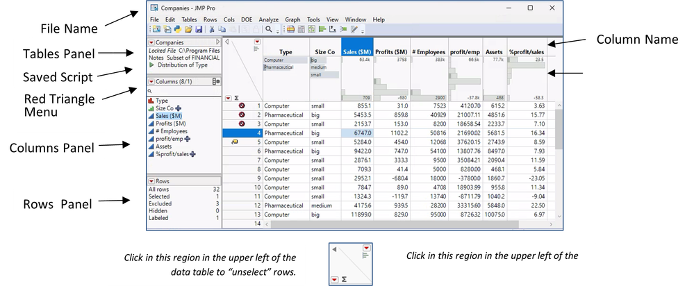

Click on File > Open to open a JMP data table. To open a file from the JMP Sample Data directory, go to Help > Sample Data Folder. A portion of the Sample Data file Companies.jmp is shown.
Portion of Companies.jmpPortion of Companies.jmp
Tables Panels
  • The data table name
  • A list of table properties, table variables, and script
Tables panelTables panel

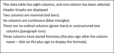

Columns Panel
  • The number of columns
  • The number of selected columns
  • Column names
  • The modeling type for each column
  • Column properties
Columns panelColumns panel

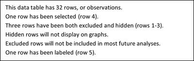

Rows Panel
  • Rows
  • Selected rows
  • Hidden rows (with a mask)
  • Excluded rows (with a “don’t” sign)
  • Labeled rows (with a tag)
Rows panelRows panel
