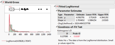

    Here we chose the variable ‘World Gross’
  3. Select Continuous Fit from the red triangle for the variable and select a distribution (LogNormal was selected in the example below).
  4. In the resulting fitted distribution output, click on the red triangle and select Goodness of Fit (shown) or Diagnostic Plot to assess the fit of the distribution.  The small p-value suggest that the LogNormal Distribution does not provide good fit to the data.

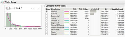

Select Continuous Fit, then Fit All from the red triangle for the variable. JMP will compare available continuous distributions. Note: The distribution with the lowest AIC value provides the best fit to the data.  Goodness of Fit tests can be performed by selecting Goodness of Fit under the Red Triangle for the Fitted Distribution output.

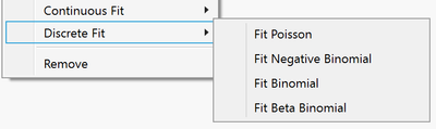

If the continuous variable contains only integer values, four discrete distributions are available under Discrete Fit.
