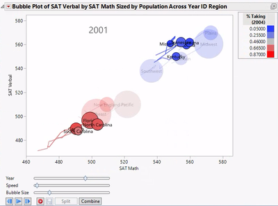

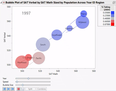

  7. Play, Rewind, and Forward button are available to have the bubble positions, size, and/or color change as a function of the Time variable.  gail_massari_0-1756130303659.png
    Note: Options such as adding Trail Lines and Labels are available under the Red Triangle.
  8. If there are multiple ID Variables (as in Region and State in this example), selecting a bubble and clicking the Split Button will separate the selected bubble into the values for the second ID Variable. In this example, the South Region was split into the individual states that make up that region. Select the Combine Button to return the individual states back into Region.
