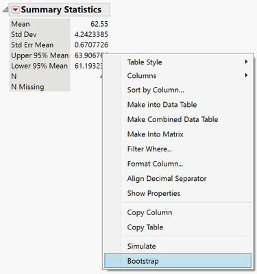

  1. From an analysis platform report window, right-click on the report of interest and select Bootstrap. In this example we use the Distribution platform and bootstrap the statistics in the Summary Statistics report for the continuous variable ‘Height’.

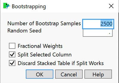

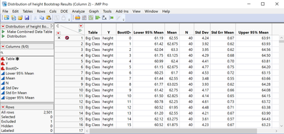

  2. In the Bootstrapping window (below, left), enter the desired number of bootstrapped samples and click OK. JMP creates a data table (below, right) with statistics for the original sample (excluded) and each of the bootstrap samples. The BootID• column identifies the bootstrap sample number.
  3. Use the Distribution platform to explore the statistics of interest for the bootstrap samples. Bootstrap percentile confidence intervals for different confidence levels are provided.
Hint: Click on the green triangle next to Distribution in the top left panel of the Bootstrap Results data table to launch the Distribution platform for all bootstrapped estimates.
