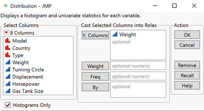

  1. From an open JMP® data table, select Analyze > Distribution.
  2. Select one or more continuous variables from Select Columns and click Y, Columns.

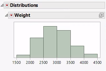

  3. Click OK to generate a histogram (Histogram Only was selected in this example).
Car Physical Data.jmp (Help > Sample Data Folder)Car Physical Data.jmp (Help > Sample Data Folder)

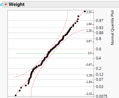

Normal Quantile Plot

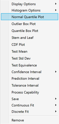

Click on the red triangle for the variable, and select Normal Quantile Plot.
If the data more or less follow a straight line (fat pen test), we can conclude that the data are reasonably approximated by a normal distribution. For this example, we would conclude the distribution is approximately normal.

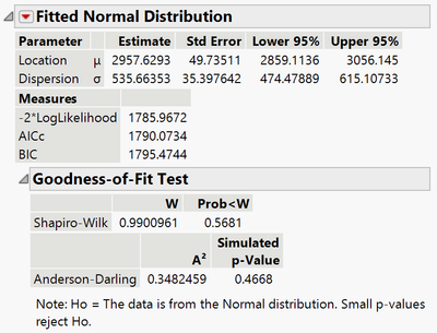

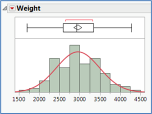

  1. Select Continuous Fit > Fit Normal from the lower red triangle for the variable.
  2. In the resulting output, click on the red triangle for Fitted Normal Distribution and select Goodness of Fit.
Two Goodness of Fit tests are performed to evaluate if the normal distribution is a good fit to the data (Shapiro-Wilk and Anderson Darling). Both have large p-values indicating that there is no statistical evidence suggesting the normal distribution is not a good fit to these data.
