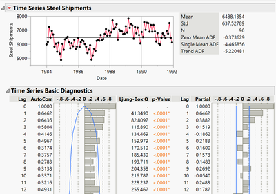

The autocorrelation (ACF) and partial autocorrelation (PACF) plots suggest an ARIMA model with a seasonal component of AR (1) and a non-seasonal component of AR (2).

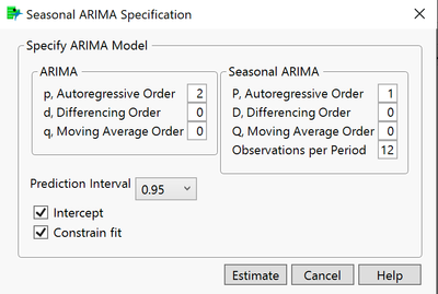

  1. Click on the top red triangle and select Seasonal ARIMA.  Enter the values as shown (right), and click Estimate. JMP displays model results.
