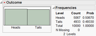

We start by exploring the frequency of heads and tails in the 10,000 flips.
Exhibit 1    Distribution of Outcome
(Analyze > Distribution; select Outcome as Y, Columns and Count as Freq, and click OK.  For a horizontal layout select Stack under the top red triangle.)
Certainly, the coin appears to be fair – there are roughly the same number of heads and tails in the sample.

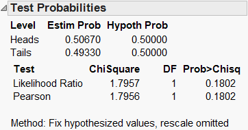

The goodness-of-fit tests (Exhibit 3) both give p-values of 0.1802. We do not have evidence that the coin is not fair. Again, the double negative is required to avoid affirming the null hypothesis.
Exhibit 3    Goodness-of-Fit Test for Outcome
(From the Distribution output, click on the lower red triangle and select Test Probabilities. Enter 0.5 under Hypoth Prob for both Heads and Tails, and click Done.)

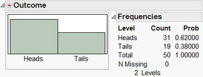

From the bar chart and frequency distribution in Exhibit 7, it seems like clear evidence the coin lands heads much more than tails. The coin actually landed heads 62% of the time in the sample, compared to 50.67% for Kerrich’s data. But, as before, inference will tell a different story.
Exhibit 7    Distribution of Outcome, Very Small Sample
In fact, the p-values are both above the significance level of 0.05, so we cannot reject the null hypothesis that the coin is fair.

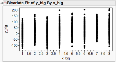

It may not look like a line would fit this data, but big data sets (n = 2,000) produce some surprises. Do you see a trend in the scatterplot in Exhibit 9?
Exhibit 9    Scatterplot for a Large Data Set (y_big and x_big)

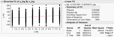

(Analyze, Fit Y by X; use y_big as Y, Response and x_big as X, Factor.)In Exhibit 10, we fit a regression line to the data. Does a line fit the data?
Exhibit 10    Regression for a Large Data Set (y_big and x_big)
(From the Bivariate Fit output, click on the red triangle and select Fit Line.)
While R2 is a mere 0.056, indicating only 5.6% of the variation in y_big is explained by the regression using x_big, the p-value is less than 0.0001 (the null hypothesis is no trend in the data, the alternative is that there is a trend in the data).
This is the power of large samples; a tiny trend is detected. However, the trend may not be of any practical importance. Certainly, if this is the rate as which my salary is going up, I would not be impressed!

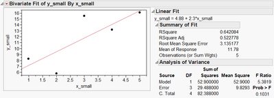

Now, let’s look at a very small sample, with y and x values drawn from the big sample. Columns y_small and x_small contain five observations.
In the plot in exhibit 5, it appears there is a strong linear trend in the data. But, keep in mind that the clear pattern in the data, but the sample size is very small (n = 5).
Exhibit 10    Regression for a Very Small Data Set (y_small and x_small)
I am sure you may have guessed where this is all going.
While the R2 is 64.2%, indicating that much of the variation in y_small can be explained by the regression on x_small, the p-value is 0.1031. This means there is only weak evidence (at best) that a line fits the data. So what is happening?
With a small data set, while a line does seem to fit the data, we cannot rule out chance as an alternative explanation for the apparent pattern. P-values are a way of assessing the probability that chance could have produced a pattern like this one. Although there appears to be a pattern, there is a 10.04% chance we could have gotten a pattern this strong, or even stronger, if the points were just produced at random with no true relationship between x_small and y_small
