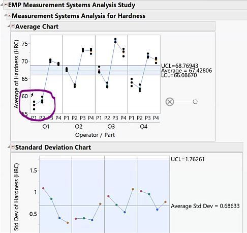

Q: Does it matter in the average chart that one point was within the ULC/LCL?
A: No, it just means that that particular part is close to the overall average of the parts. You just want most of the parts outside the UCL/LCL range.
Q: Is the EMP methoday different than variability charts?
A:  Using the gauge variability chart, you're essentially kind of looking at the same setup. So you could use that platform and it's generating, the gauge variability output.  That would be very similar to the variability chart with the the means connected just by showing the data and then the line goes through through the middle. The graphic is similar. What you get in this case are the  control limits and n>the ability to kind of infer that a are my are my parts outside the control limit.
