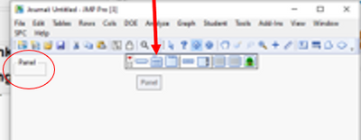

Q: What is the Panel for? This is some of the panel. It allows you to consolidate/enclose parts of the Journal into on visual container.

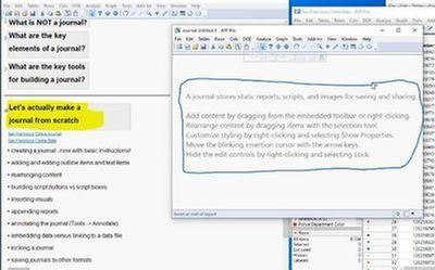

Q: What are the basic tools for creating and editing Journals?
A: The Journal toolbar of course and the Arrow and Selection Tool (Fat Plus) are key during editing.

Q: How do I add text and indent items?
A: There are at least three ways. See how:
