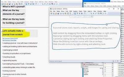

  • Build a Journal
    • Start Journal using File>New>Journal
    • Create text item using Journal Toolbar or R-click
    • Edit text font using R-click
    • Create Outline item using Journal Toolbar or R-click
    • Nest Text
    • Select and move text using JMP Toolbar Selection Tool and blue line that identifies possible Drop zones
    • Add link to data source under Outline Item using Red Triangle
    • See link URL under Outline Item using Red Triangle>Set Script
    • Change URL link to Button
    • Add picture using drag and drop or JMP Journal Toolbar
    • Add non-interactive static JMP Report as picture using Select/Copy/Paste
    • Add interactive JMP Report using Save Script>To Journal
    • Annotate Report in Tet Box in Journal using Tools>Annotate
    • Embed files from your desktop or server and edit file path using Set Script (If there is no path, and file lives in same location as the newly-edited/saved journal, filename alone (local reference) will suffice.)
    • Format spacing by Adding empty Text Item
    • Add spacing to area using R-click>Show Properties and then selecting area and add Padding, move left/right, change alignment/justification
    • Lock Journal and exit Edit mode using R-Click>Lock

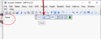

Q: What is the Panel for?
This is some of the panel. It allows you to consolidate/enclose parts of the Journal into on visual container.
