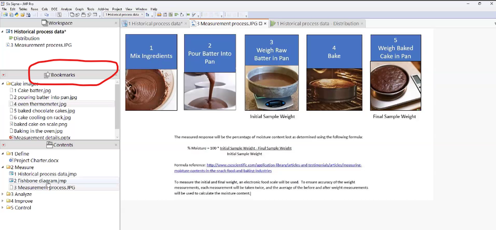

Q: In a JMP Project, if you open and modify bookmarked files are the native files affected or are they self-contained once opened like Contents files?
A: The Contents folder lists that are part of the Project, so if you want to include them to send to other JMP users using the Project, include them. Bookmarks look outside the Project. If you modify a bookmarked file, you are modifying it in its saved location.
Project Bookmarks link to items outside the Project
