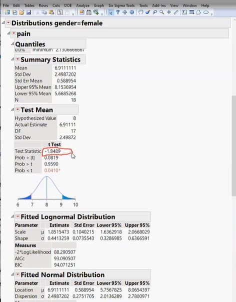

  • Compare and interpret Confidence Interval on a Mean Value
  • Compare Mean to a Target Value
    • Analyze>Distribution and then Test Mean from red triangle
    • Interpret Quanitles, Summary Statistics, Means Test
