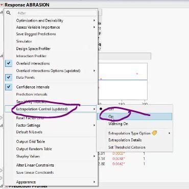

Q: Can we extrapolate in Prediction Profiler?
A: Yes. If you go beyond in the Prediction Profiler you will be able to turn on Extrapolation Control to get a warning if/where extrapolation is not sensible.  It will flash a red textual warning if there is and issue.  Be careful extrapolating in a model, because you may have not data to back up the results.

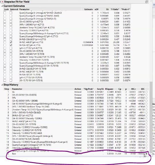

Q: How do I know the Best model in Stepwise Regression.
A: You will see it in the report. Check the circle to the left of it and JMP will run it.
