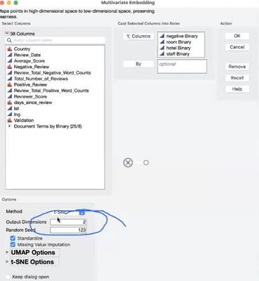

Q: t-SNE plot: what does x-y #s mean?
A: For that I would recommend watching a video on multivariate method clustering or on teaching clustering. In this case, we had 25 different columns and reduced that multi-dimensional space down to 2. Think of this as similar to principal components.  You can choose how many outputs (or components) you want.

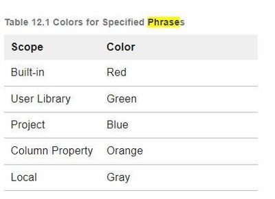

Q: Sometimes there is red text in the phrase list. What does that signify?
A: It identifies a default color in our library.
