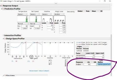

Q: The DOE has uncertainty represented by the RMSE.  Can this be incorporated into the prediction of % in-spec?
A: Yes.  RMSE is automatically brought into the Design Space Profiler if it is launched from within Fit Least Squares.  You can see it in the "Response" section of the Design Space profiler near the spec limits.  It can be edited as well.  Additionally, in the Design Space Profiler in the In Spec section you see the response standard deviation in the bottom, right hand corner. That root mean squared error is coming automatically from the Fit Least Squares model.  You can change it to anything you want it to be and easily add whatever prediction area you want and then that is what gets used to do the simulation, and then estimate the in-spec portion.
