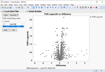

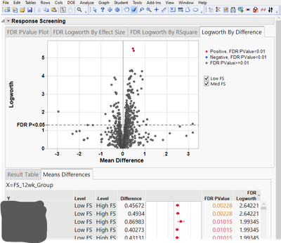

  3. Is it possible to change the graphing on the volcano plots in the Response Screening to color FDR Pvalues < 0.02 or <0.05 (and not the defaulting 0.01)?  I can change the location of the reference line (see image below) but it would be nice to have points colored consistent with an FDR cutoff of choice and also have the legend updated on the Logworth by Difference plot.  I thought a workaround would be to generate a new table of the differences (log2 FC) and P-values and take them into GraphBuilder where I have more control but I get the same coloring of only the points <0.01 so the coloring setting seems to follow the table (see image below).

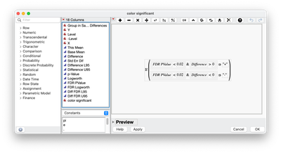

  3. For JMP Pro 17 or JMP Pro 18 (released in March), this is currently not possible. I do something similar as you did.  I save out the Means difference table (Red Triangle within Response Screening and choose Save Tables>Save Means Differences) and then use graph builder with a local data filter. I also will use Rows>Row Selection>Select Where to select rows that are below a threshold of choice and difference threshold. Then I use Rows>Row Selection>Name Selection to Column to create an indicator column(s) that I can use to concatenate for a column I can use in the color option in graph builder.  Another option is to use a column formula where the conditions are added and an if statement. I like this option better since it is a single action and saved within the column as to what I am doing.
