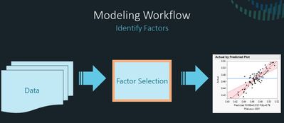

See how to:
  • Use JMP Partition to identify significant factors
  • Accurately and automatically any model interaction effects
Modeling Workflow with Factor SelectionModeling Workflow with Factor SelectionModeling Workflow with Factor Selection
