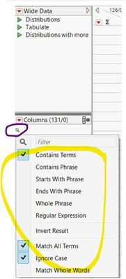

Q: How do I search within Rows:
A: Click in the search box to get options for how to search the values you put in search box.
Click in the search box to get options for how to search the values you put in search box..jpg
