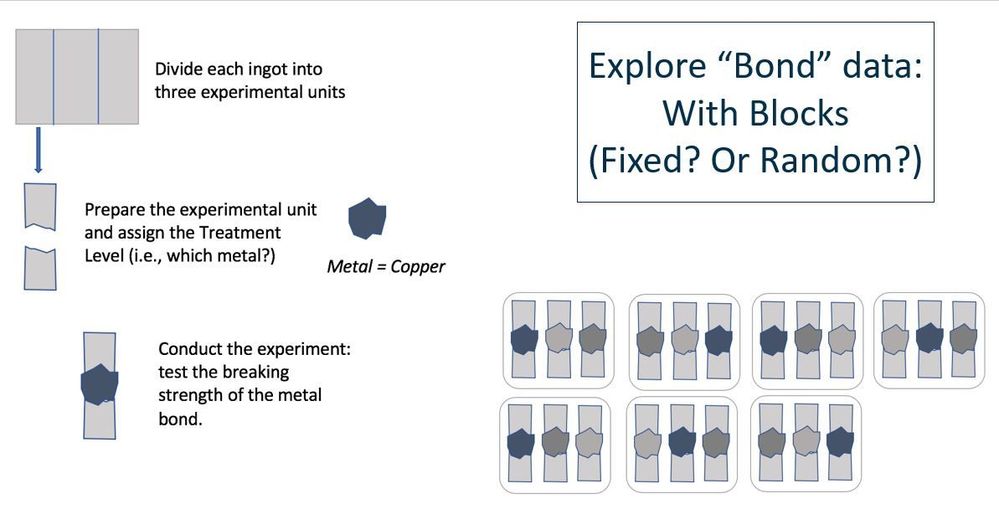

  • Learn rationale and techniques behind JMP’s mixed model capabilities, see when and how to use mixed models, learn how to recognize, set up, and interpret fixed and random effects and see how to extend Analysis of Variance (ANOVA) and linear regression to numerous mixed model designs.
  • See how to understand and use degrees of freedom: analyze randomized block, split-plot designs and random coefficient models; and address modern dilemmas around Bayesian methods and p-values.

    • Fixed Effects are exact factors/levels and you want to make inference for a future observation from exactly those levels
    • Random Effects are when the levels are a sample from a larger population, and you want to make inference to the larger population and not just to those specific levels, and/or when you are primarily interested in explaining the variability coming from that effect rather than, say, pairwise comparisons
    • Mixed Models incorporate Random and Fixed Effects
  • Mixed Models are useful for handling Random Effects and with a mixed model, we could have possibly different results for the estimates the confidence intervals and those pairwise comparisons compared to a fixed effect only model.
    • LSMeans are not necessarily the arithmetic means. Missing data/imbalance needs REML to better estimate the LSMeans
    • With missing data/ imbalance, the pairwise comparisons for the other fixed effects are also affected by the choice to model an effect as random.
    • Don’t rely only on the p-value – remember that p=0.049 and p=0.050 are basically the same thing.

  2. For this block example. Aren't you describing a nested situation? This behavior would happen in nested models, but this is not a nested example since treatment is not unique to block.
