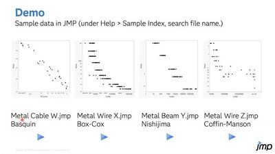

Q&A is included at the end of the demo, beginning at time 1:09:00. The sample data used in the demos is available in JMP 18:
JMP 18 sample files used in the demoJMP 18 sample files used in the demoJMP 18 sample files used in the demo
